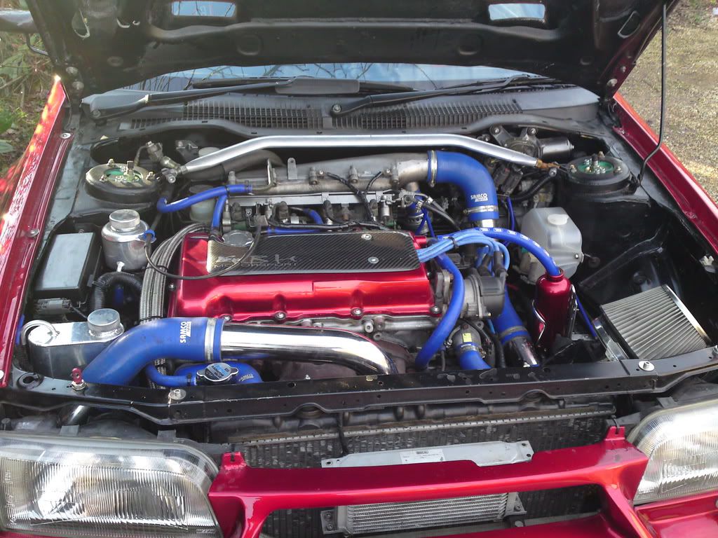

An engine pic...... :oops: got a lovely build planned but that wont be for some time! the "catch tank" is tempory by the way!
found a feature on a GTiR weighing 1060kgs! :o don't know if thats 100% true but that's bloody light!
Catch can..............that's even colour coded too! Tart :)
