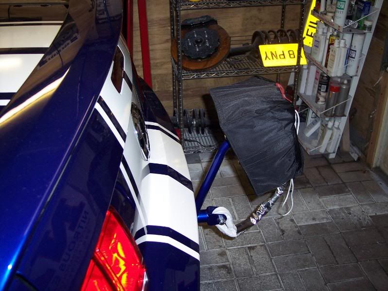

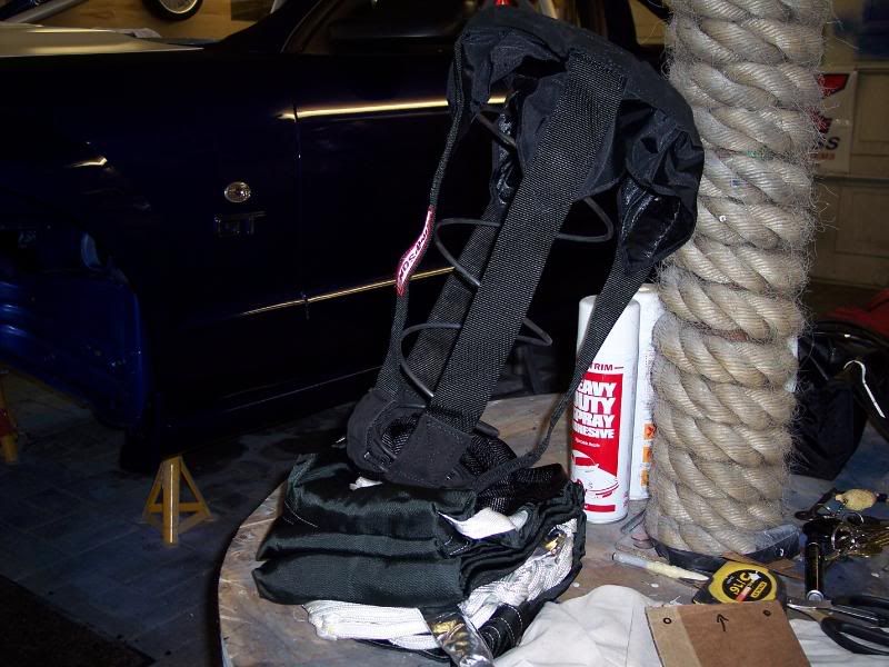

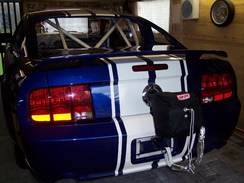

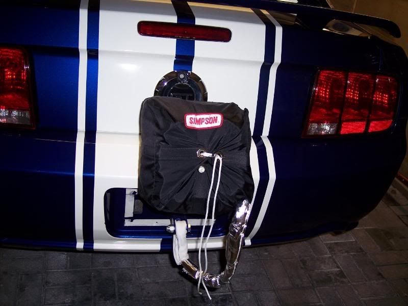

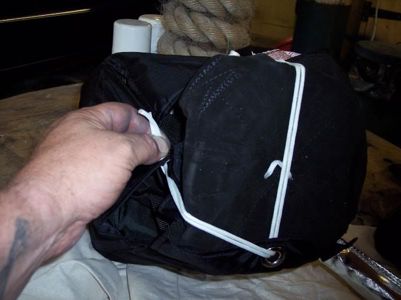

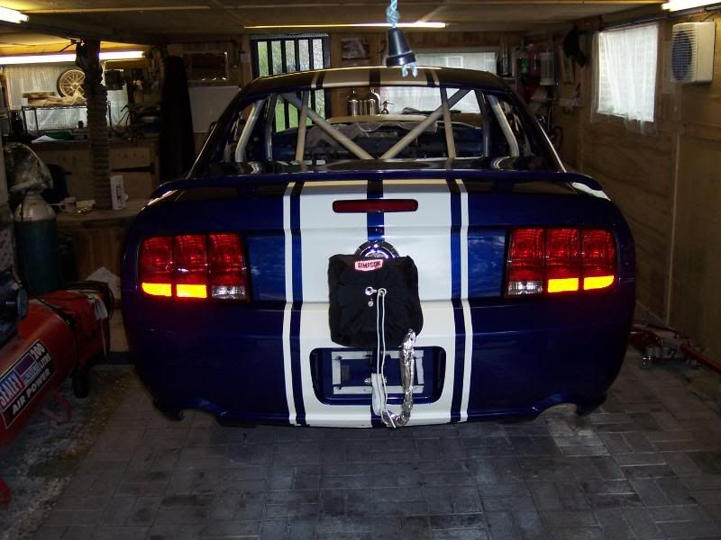

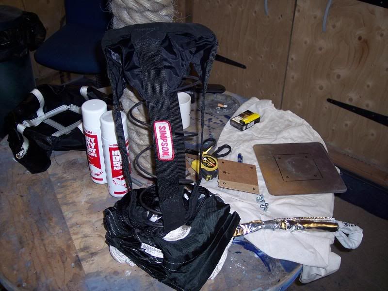

Next project was to get the chute hooked up, I had never seen the inside of one of these things so was really interested to see how they worked. After unpacking the chute I made up a template for drilling the holes, mounted the bag on the bracket and then repacked the chute, I can't believe how much tension is on the spring inside these things it's a two handed job just holding the spring in the bag and then with your third hand you have to thread the string through the holes. I'm sure it gets easier when you learn the knack of doing it
