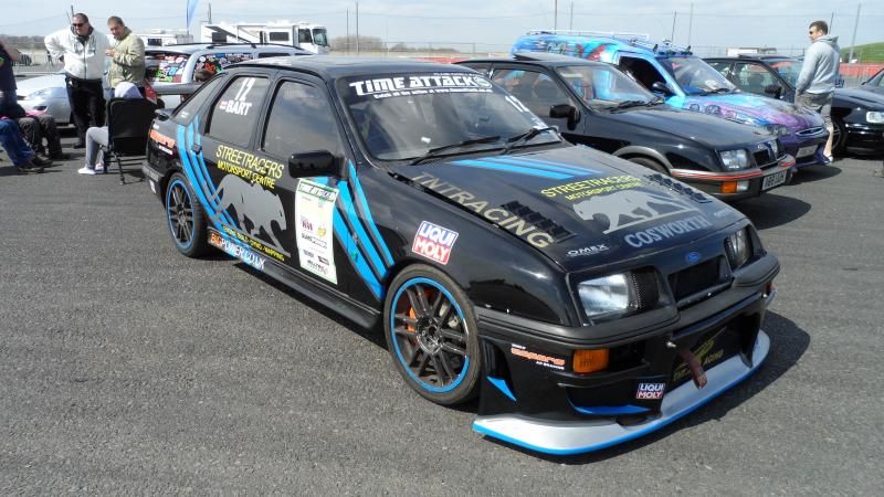

Found this pic of the car.
The day was not a total waste. I have now seen some pics of the car on launch and under accelleration and the front end does not lift like it used to. So we know the changes to the front springs have improved it so we're going ahead with having custom springs made up.
There won't be many occasions where you'll experience full bore launch style vehicle dynamics on a race track under normal circuit driving though Pablo. Are you trying to get rid of front end lift on hard acceleration on the corner exit? If so, wouldn't a different ARB provide a better solution? (Flatter at exit therefore both tyres at the front getting the same footprint.......although flatter may induce more understeer too)
Sorry to jump in with my thoughts without knowing what you're trying to solve......I do that with murder mysteries on telly too :thumbs:
