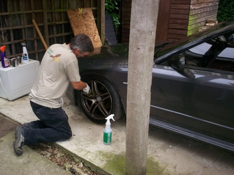

After micrometering the car ( my new word) Gary started on the scabby brake dust mullered wheels, good luck.

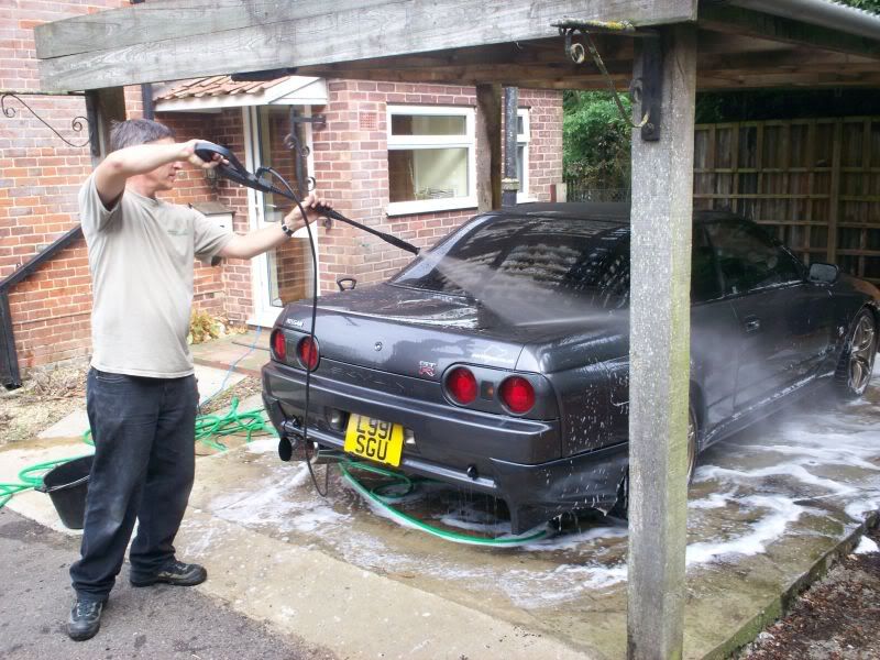

Spraying the wheels liberally with an alkaline solution and scrubbing like a mad dervish using three different brushes to agitate the most stubborn of the baked on dirt. This was followed by a very thorough pressure wash job.
The car was then treated to a degrease using natural orange zest as a solution and this was applied to the entire lower third of the car. The smell was amazing. Arches, wheels, bumpers, sills all treated to a heavy dose of vitamin C.
The car was then rinsed again using the jetwash.

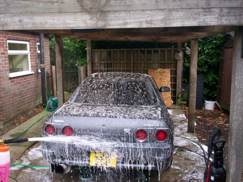

The next stage was great. Snow Foam is a really thick heavy sudding soap used to remove loose dirt and particles sitting on the paint.
This was rinsed again and then another coat of snow foam was put on, this time the soap suds were washed over the panels using the finest sheepskin mitts, ensuring all metal work was completely massaged with the solution. More rinsing and then dried by hand using waffle weave microfibre clothes. The time was now 12 noon. 3 and a half hours and we had only just finished 'shampooing' the car!

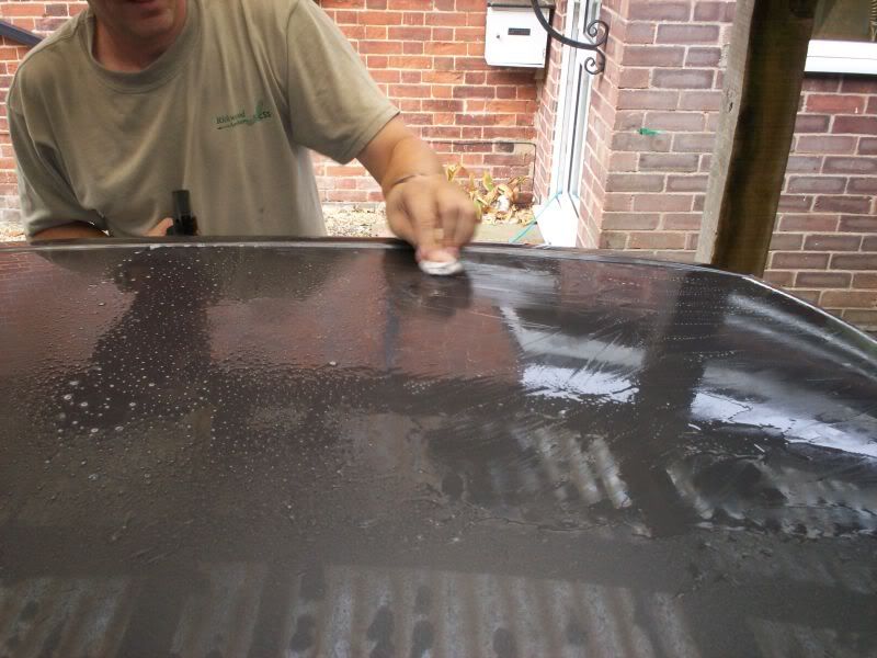

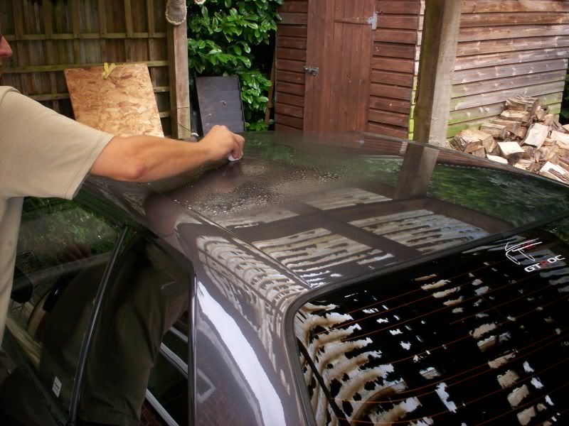

The next stage is one I've read and heard about but never seen.....clay bar and detailing spray. Essentially this removes all of the contaminants on the paint, tree sap, overspray, tar etc and leaves the metal work glass smooth. Sounds like cobblers, but if you've never tried it you will be stunned. (Bloody hard work graft though)

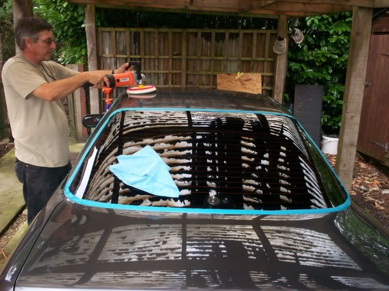

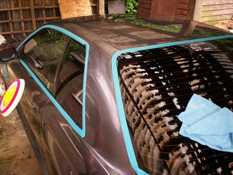

Next was the masking in in preperation for the machine polishing. This in itself took about 20 minutes, the amount of time spent is staggering, and I thought I knew how to clean a car.
Gary uses a choice of polishes subject to the amount of cutting he needs to do, this is governed by paint thickness, level of swirls or other defects and your wallet. So in my case that was varied, numerous and empty. The actual process is pretty straight forward though and this is when I shot off to do some lunch. (Truth be told, Tan did it)

Here are a few pics I managed to take, and I'm sorry most of the completed one are blurry due to me getting a little chilly and wet, plus I guess not turning the flash on didn't help while the light faded.
You really should have seen Stu's face when he first pulled the trigger, like a kid in a sweet shop :)
Top clay bar after doing just the boot lid, bottom one after Stu cleaned the nearside wing
After machine buffing, but nothing added
After the wax was buffed (sorry again for blurry pics they really don't do the car justice)
