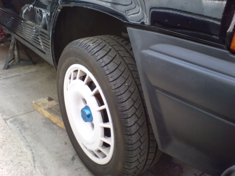

Bilstein rally suspension and Compomotives so a few quids worth there.

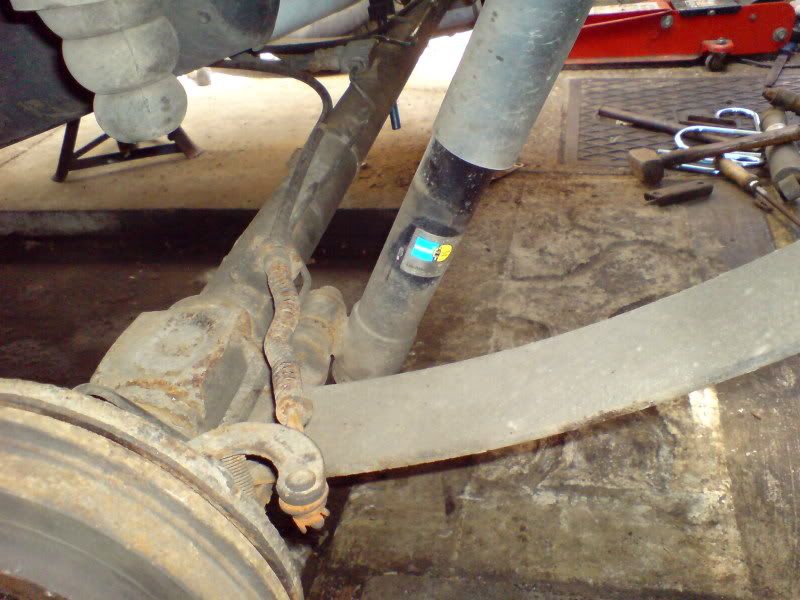

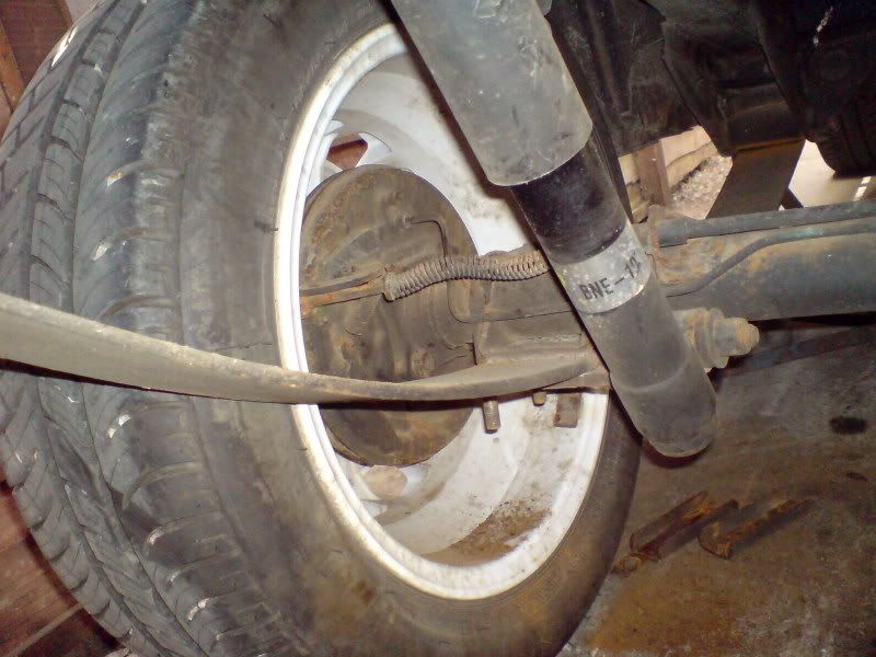

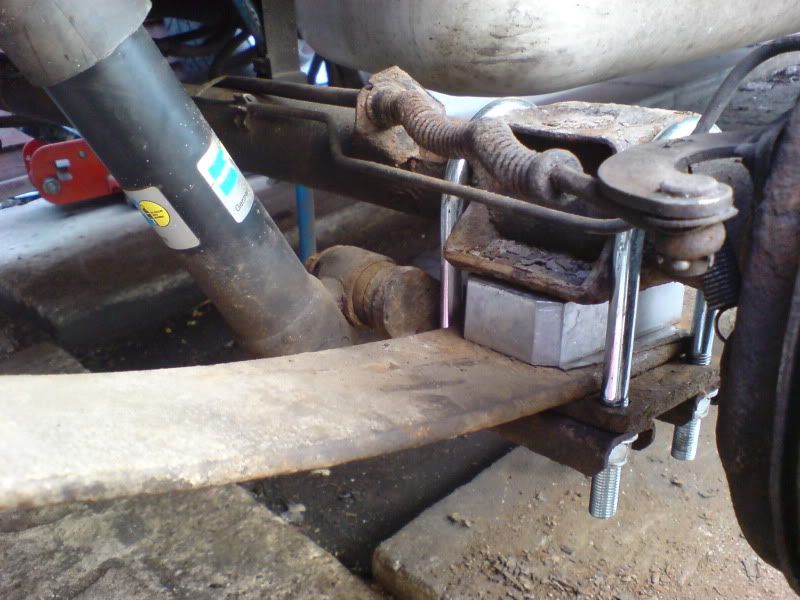

Due to the car being too high at the back now, he asked me to lower it. I used a Ford kit and modified it. He was well chuffed as noone else would do it.
