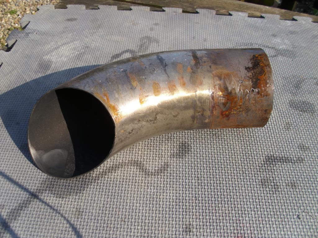

An example of recently completed work
The custom exhaust tip from APT's Evo

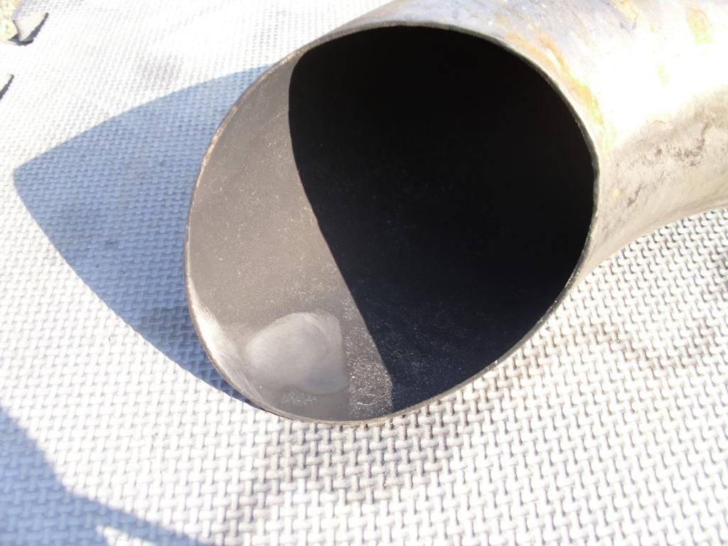

You can see the carbon build up on the interior and the general staining and corrosion marks on the exterior. Not exactly ideal when your car is being featured again in a magazine so time to flex the elbow grease again

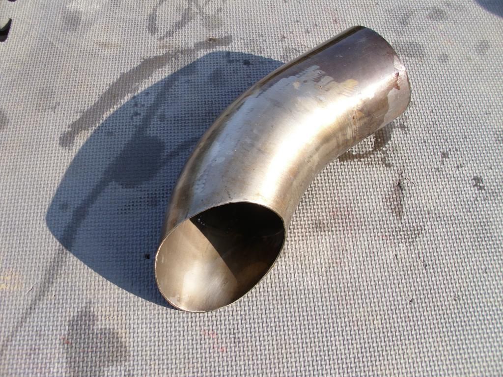

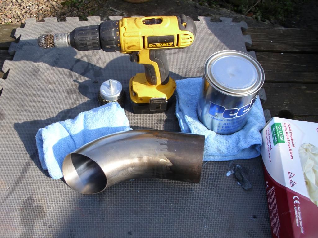

With the exterior soaked in mild chemicals to safely remove the carbon deposits, the corrosion marks and general stains I then moved on to a fine wire wool and protective metal polish to finish the job
The microfibre was used to remove the polish and the De Walt was used to de-burr the end of the pipe that goes into the silencer :headhack:
Oh well, I've got nine other fingers :D
