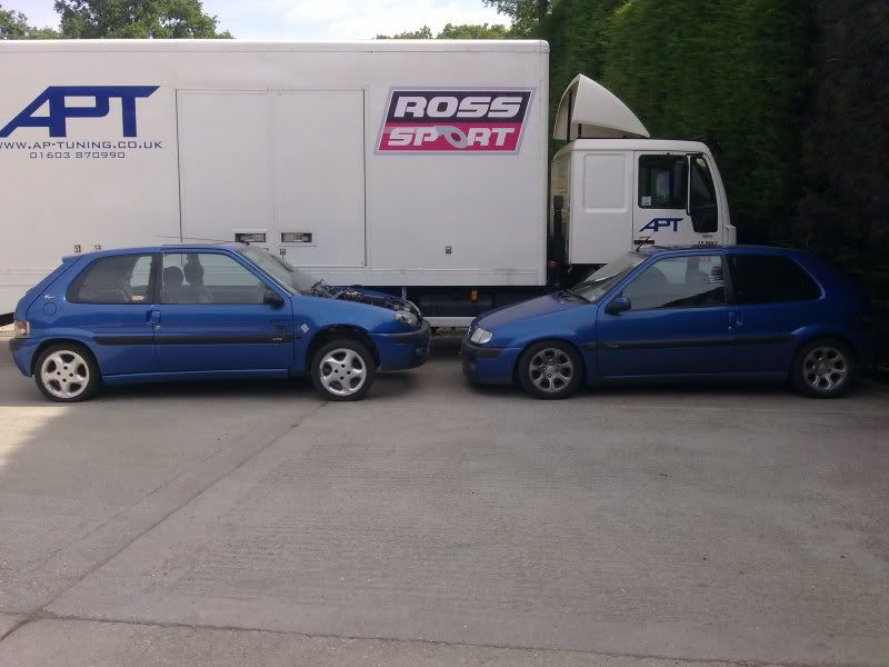

As it happens, one of Gary's contacts had picked up a VTS to have as a spare shell for his 1.6 8v VTR race car. Therefore he would have no use for the 16v engine. So he dropped the car off in the yard, and once we were done he picked it back up again-
Quite comical really.:rofl:

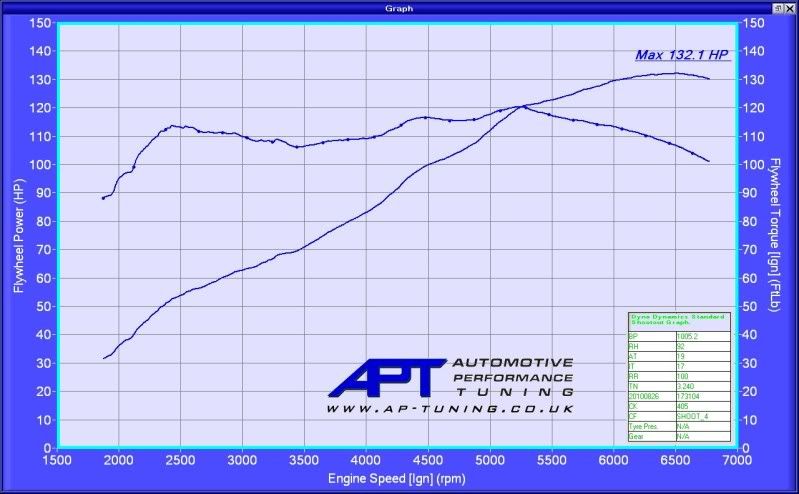

Before-

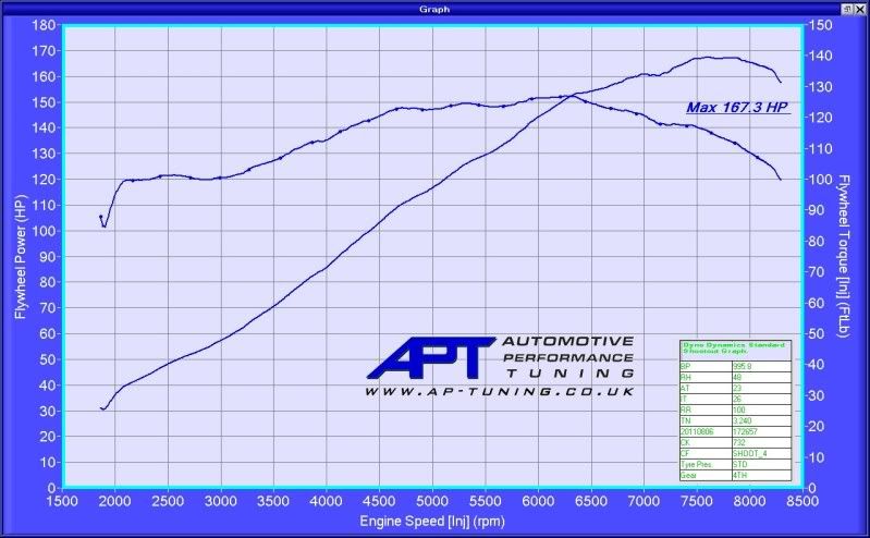

and after :D -
Unfortunately can't overlay the two due to the idiosyncrasies of the Dyno software (second run was using the injector wiring for rpm instead of the ignition pick-up), but you can see the power is up from 4k onwards, and torque is increased from 3.5k, with a "Vtec Yo!" rev limit of nearly 8.5k. :driving:
However, with the throttle bodies being at the rear of the bay, heat-soak is an issue. Gary has some chav-tastic ideas for directing cold air back there. :smilielol5:

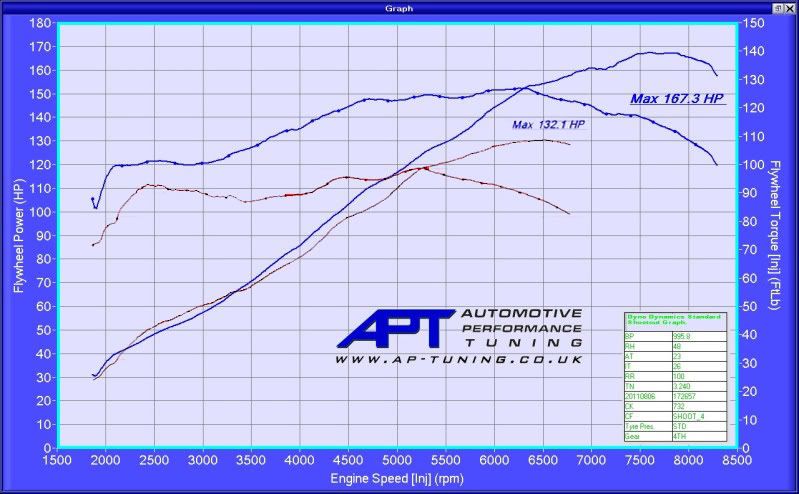

oh and here they are overlayed to scale ;)
Bloody good gains :)
gary@apt
Posts: 1527
Post by gary@apt »
daniel torque scaling is dotted line and is on the right, bhp is on left

gary@apt wrote:daniel torque scaling is dotted line and is on the right, bhp is on left
:thumbs:
Good effort though Dan (basically just move the end of the old torque line up to about 100 lbft- same as the newer one). ;)
