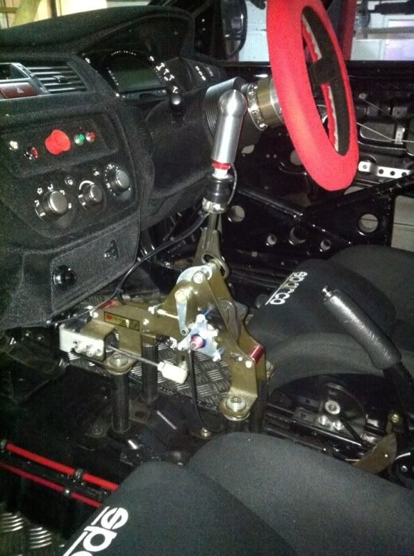

few things have been since this was last updated
load cell added to ikeya for throttle blip and flat shift

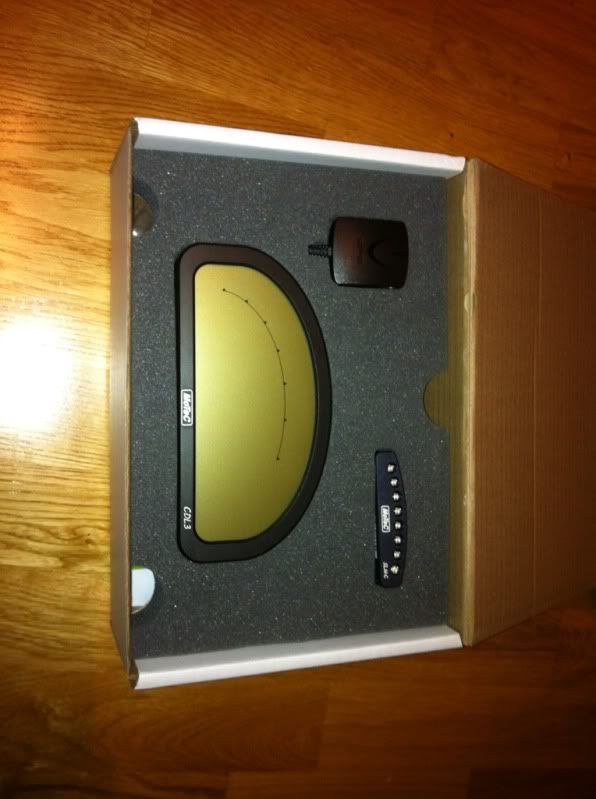

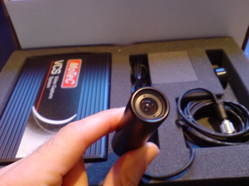

ive always wanted a motec dash so sold aim one and motec just released there cdl3

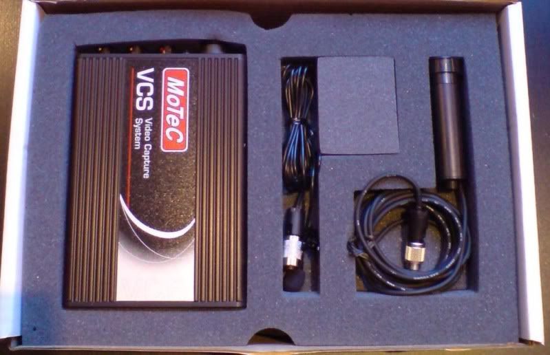

and a nice camera system too

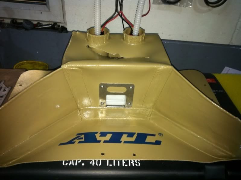

Post by gary@apt »

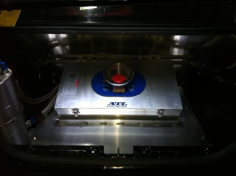

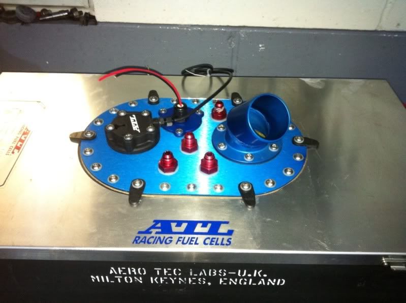

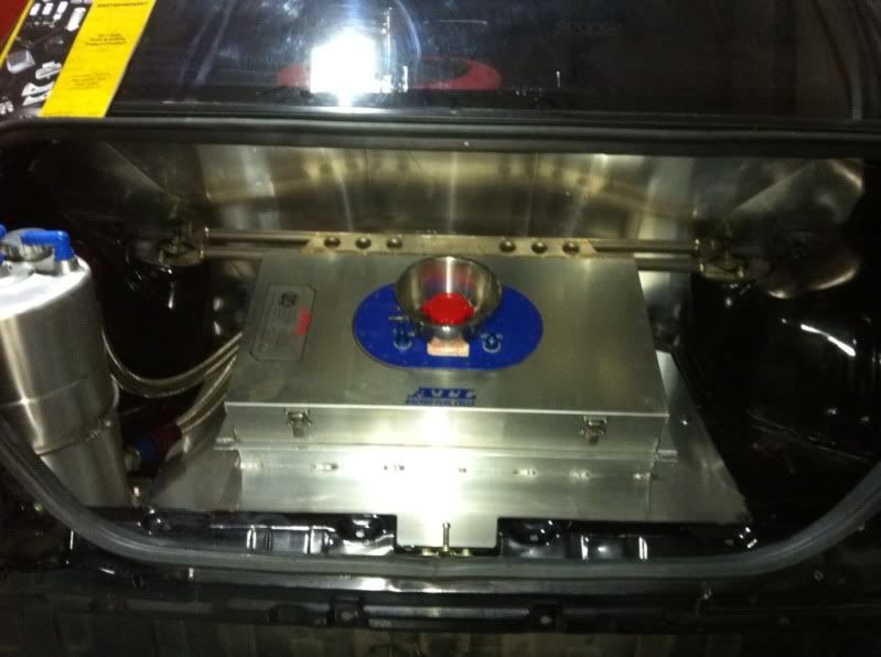

with no boot floor i came across a cheap atl 40litre fuel tank, alloy boot floor made and tank fitted

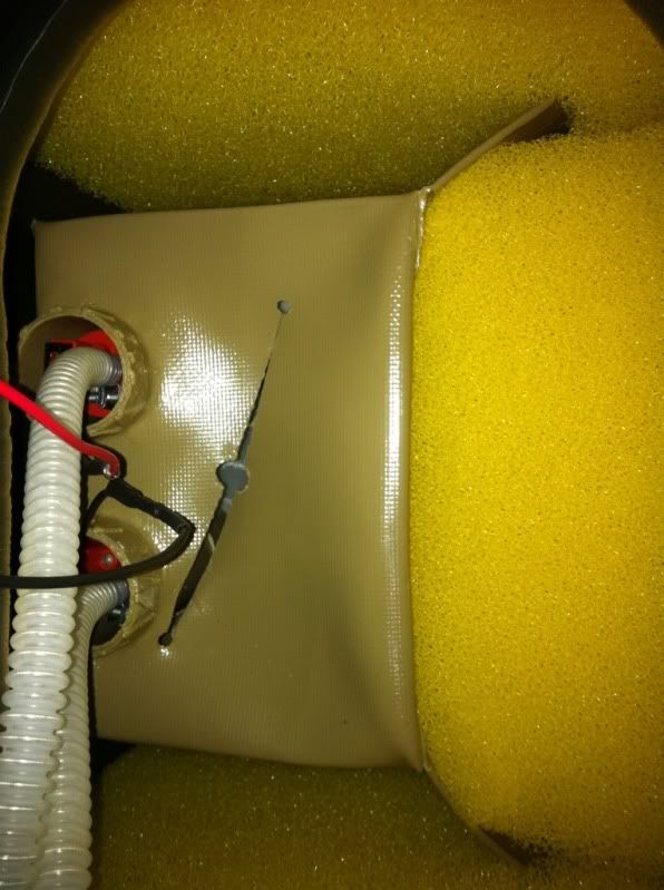

Post by gary@apt »

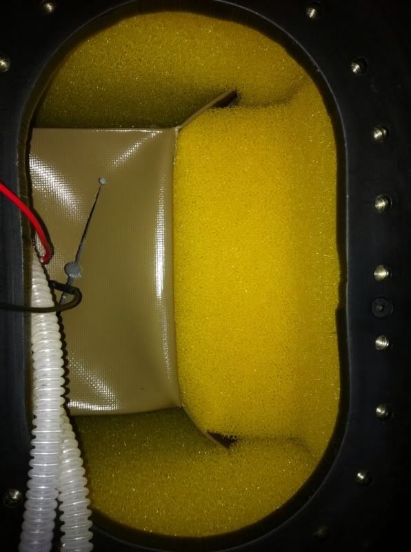

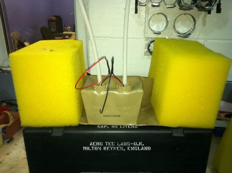

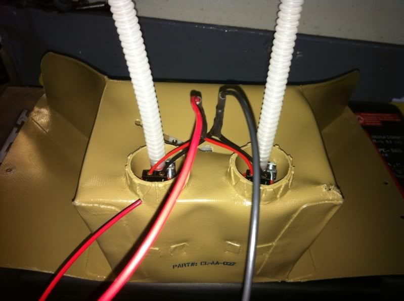

i used to run twin walbros and never had any issues so wanted to keep twin in tank pumps,so 2x aeromotive 300lph ordered and some fancy baffles from atl

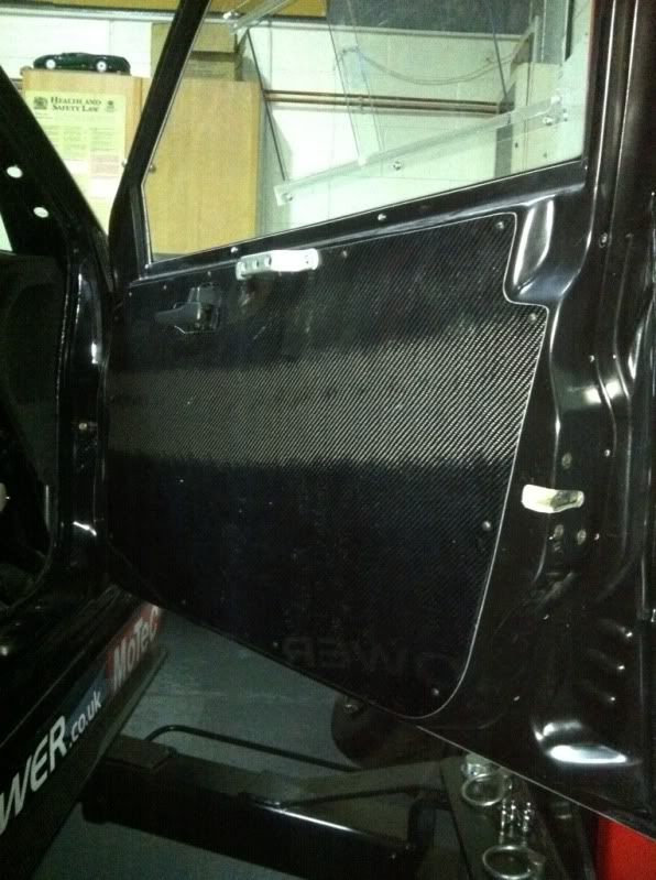

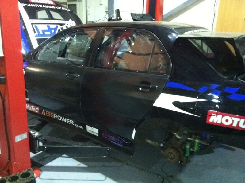

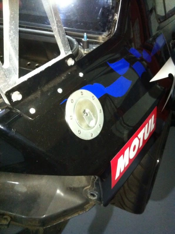

and with need to reduce weight comes F/G doors from robin d,
to say these were fitted in less than 4 hours with very little work needed
