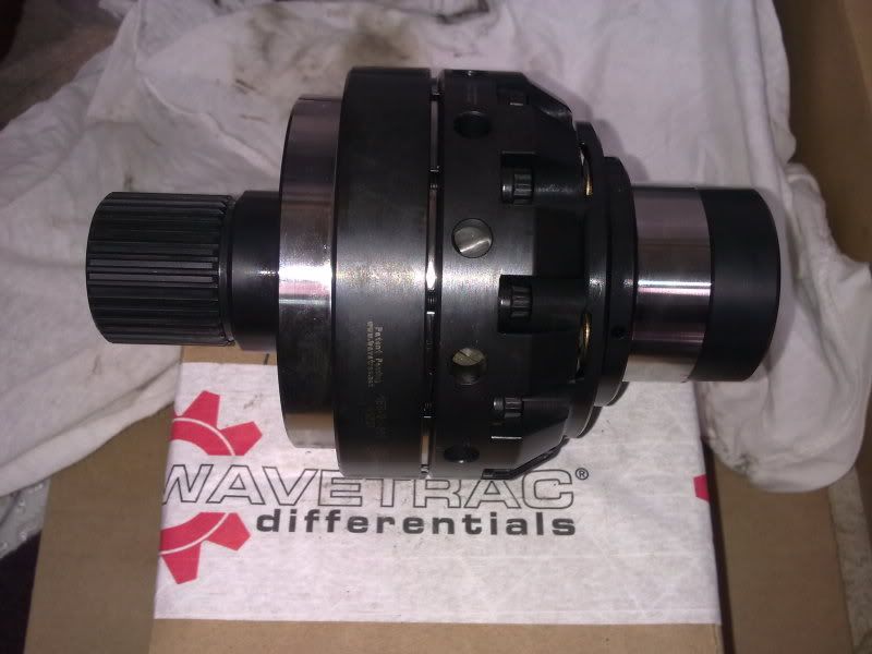

New Wavetrac front diff-
Finishing off the Ford ;)
Wavetrac?! Hayward's been waving the mighty APT wand again :D Heard that these things are superb; so highly rated :thumbs:

thanks stu,danny does a great job of updates! ,he wants pics before i fit bits

gary@apt wrote:thanks stu,danny does a great job of updates! ,he wants pics before i fit bits
Because you get too carried away, you sod! Trevor spent ages on pocketing the Saxo pistons and no-one will see them now the head is back on (fingers-crossed). :rofl:

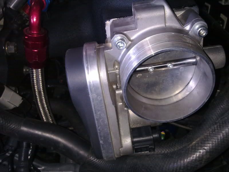

Had some time for a spot of mapping today-
http://vimeo.com/26737487
But an issue kept rearing its head-
http://vimeo.com/26735580
On closer inspection, the R32 Golf throttle body has almost no lip to retain the hose under boost (obviously not a problem for its original NA application)-
A bit of an over-sight, but we've already removed and sent it to have the body machined ready for next week.

Danny@APT wrote: A bit of an over-sight, but we've already removed and sent it to have the body machined ready for next week.
LOL, man boost makes shit fall apart :D
